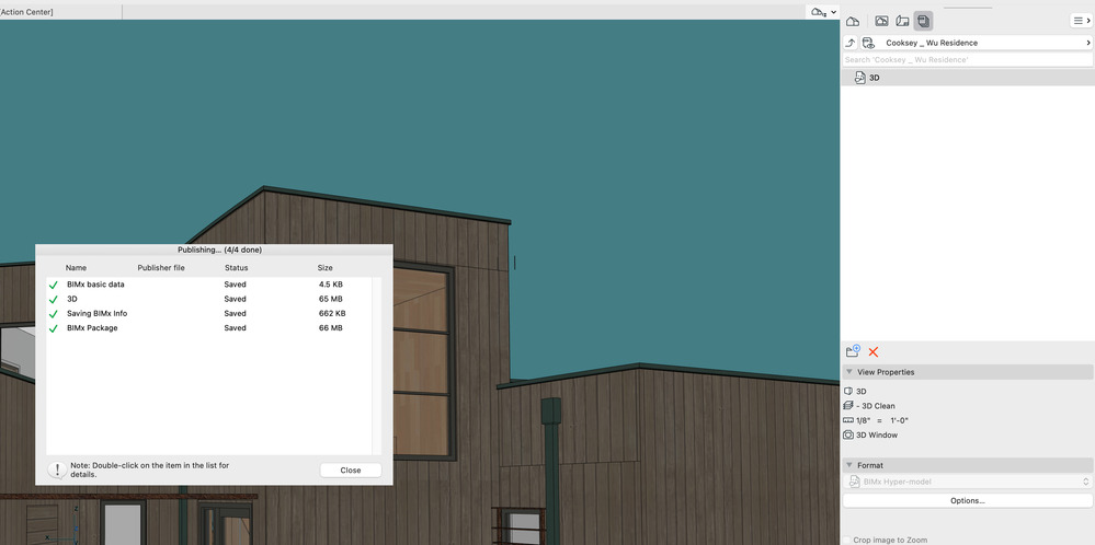

Attached is a screenshot of the publisher set (which only contains the 3D) and the publisher results.
I also just reinstalled the BIMx viewer just in case, but that also didn't change anything.

It certainly all looks good for creating the BIMx file.
I don't have 26 yet so can't test if there is any problem with 26 and the desktop viewer.

Checking the attachment it seems to me that you happen to use the old desktop application for opening the file.
Since Archicad 26 the exported BIMx models are using a single, modern 3D format you can read about in this article.
I suggest downloading the new application and check if it solves the issue.
