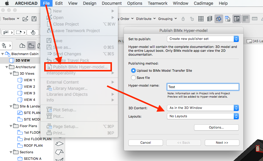

A Hyper Model can be viewed with the desktop viewer....
you just can't see the "Hyper" part (2D floor plans, sections or elevations).
You'll only get the 3D model.
Test it yourself with an existing hyper model.
