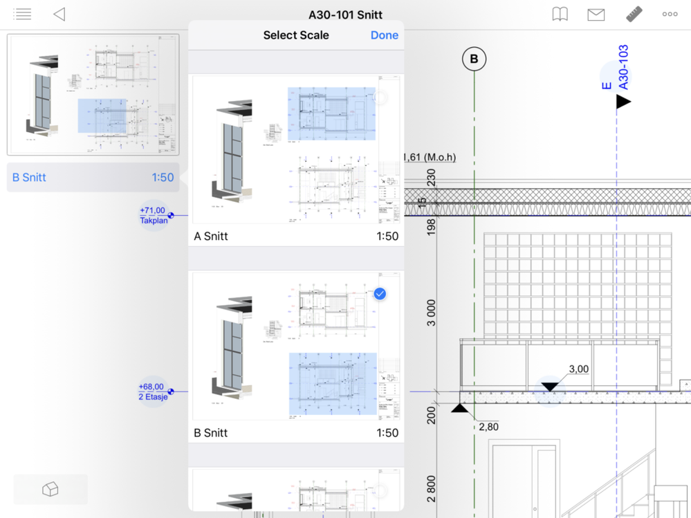

Switching between scales on layouts
One layout may contain several drawings, and in some cases each drawing can have a different scale. To make sure that the measure tool correctly takes the scale into consideration do the following:
  • Activate the Measure tool
  • Place the first measurement point
  • On the top left corner a small popup will appear, press the drawing name, the list of scales & drawing present on the layout will be displayed
  • Select the appropriate scale (the selected scale will be marked with a blue checkered circle)
