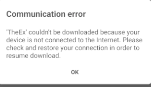

Opening the BIMx app from my app via a deep link is not working
DAMHONGDUC
My link is a redirect link: yhk.tgl-cloud.com/cdn
deeplink: bimxapplication://yhk.tgl-cloud.com/cdn?name=TheEx&folderId=123456&type=HyperModel&trsite=1&protocol=https
The error is: Communication error

Oleksandra Vakariuk
Hi @DAMHONGDUC,
The link to the file is supposed to open the download dialog like in this case for example:
https://bimx-storage.graphisoft.com/Download/0d020f3f-d95b-4941-8de1-0fd18b3bdf48
bimxapplication://bimx-storage.graphisoft.com/Download/0d020f3f-d95b-4941-8de1-0fd18b3bdf48?name=BIMx%20Demo%20Hyper-model&folderId=122826&type=HyperModel&trsite=1&protocol=https
Feel free to check our BIMx API documentation for further details.
