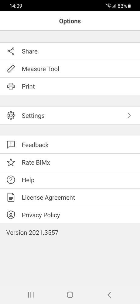

Choose Print from the Menu and configure Print settings
Once you chose the view, tap the more options menu button in the top right corner ("...") of the application and choose Print. On the next two pages you can define the Printing settings:
Print Area defines whether you print the Entire Drawing or only the region you are currently zoomed into. Setting Scale to Original lets you print the drawing in the size that was defined within Archicad for the Layout. Choosing Fit to page adjusts the printed image proportionally to the paper borders.
Tap Next, and choose the printer on the 3rd page or save as PDF. After setting up the number of Copies, Paper size, Color and Orientation and more you are all set to Print the Documentation you needed. When you use the save as PDF option you can define the location where to save the document in an extra step.
