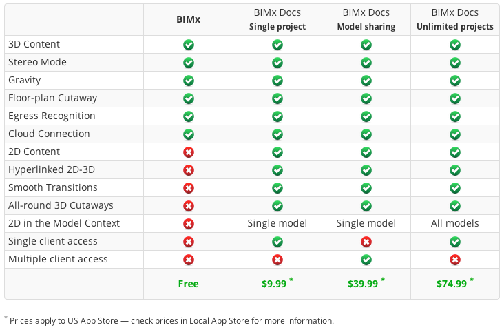

We have a full license of BIMx Docs ($75 iTunes).
Which does allow us to share their ONE model including documents with that ONE client.
Correct!? (see Pic)
We tried sharing the BIMx Docs with a client it let them see the model but, did NOT let them see the documents without them making a purchase
Thus, not really understanding the sharing concepts.

Yes your client needs to buy the App.
Your client can buy either version,
  • - $9.99 version applies only to that particular model, if the model changes then he needs to pay again
    - $39.99 version applies to that particular project if the project changes it can be updated but the link need sot be opened within 7 days of being shared and if you share another model then he needs to pay again
    - $74.99 will open any BimX project forever
The BimX link can be shared but anyone else that wants to open it needs to buy the App.
In the previous links you would have found this one (http://helpcenter.graphisoft.com/technotes/bimx/bimx-docs-in-app-purchase-sharing-for-current-projec...) that lists all Help Center articles relating to BimX and licensing that apparently you have already seen and would have seen that my opinion is to just GIFT the full $75 app to your client. Also you would have seen that nobody understands the sharing options.
