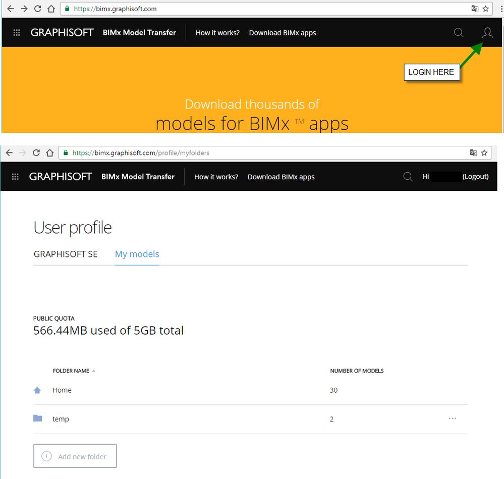

Where do my Hyper-Models go when pubished to "Public"?
rob2218
where do my Hyper-models go when I create a publishing set to only publish the 3d model to the "Public" domain?
I can't seem to find them anywhere on the net, on the BIMx site, on the Graphisoft site?
Iv'e tried to log in to my BIMx account and I can and I am logged in but just can't seem to see where my model is?

Log in the BIMx Model Transfer site (https://bimx.graphisoft.com) and you will find all of your uploaded Hyper-models.
Regards,
Gyuri

thank you.
I'll look into that.
it seems that on my iphone, the 'login' interface doesn't look the same but i'll give it a try.
thanks.
