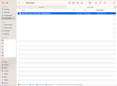

Secondly, I go to my laptop, open the BIMx app, hit BIMx Model Transfer, go to our profile, download the BIMx Hypermodel, and a very strange file downloads, which can't be opened with BIMx. So how do I get the Hypermodels from our BIMx Model Transfer site to my laptop, and again - collaborate with my colleagues?
See the image bellow - this is the type of file which downloads from our Model Transfer site.
So what am I missing here?
