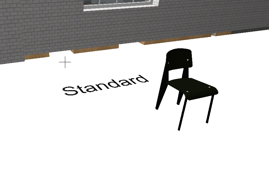

I have downloaded furniture from vitra.com, in 3ds format. I import the furniture with 3ds studio in. Everything works good except the name of the furniture is also with the furniture, in 2D and 3D. Does anyone knows how to remove it? is it possible? Almost every furniture from vitra comes in groups, can you separate the furniture from each other? Can't use 6 tables next to each other when i only need one.

I don't see your ArchiCAD version in your signature.
If you are in ArchiCAD 16, it is easy: conver the element into a Morph, delete that unnecessary part, then convert it back into a Library Part.
