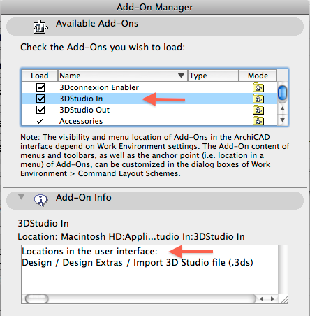

Open Add-On Manager and verify that there is no error message associated with the 3DStudio In add-on. As seen in the attached screenshot, the add-on itself will place its menus where you anticipated them: Design > Design Extras > Import 3D Studio file
Many people like David use their Work Environment to put this into the File Special menu as well, as it makes sense to be there from a consistency point of view.
Cheers,
Karl

i 've jsut opened the add-on manager and it seems that my file is outdated on. need to get a new version, right??
Right. The hotfix process updates any installed add-ons, so it is possible that you installed an older version of the 3ds-in addon after applying a hotfix.
Just go to the Help menu to get to the goodies download site to get the updated add-on (assuming that the most recent one for today's hotfix has been put there already).
