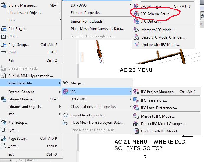

AC 20 to AC 21 : Where is IFC Scheme Setup?
Hello -
Looking high/low for where the IFC Scheme Setup went to from AC 20 to AC 21, with no success.
Any help would be appreciated!
1 ACCEPTED SOLUTION
Solution
This is the answer to the original question of where is the IFC Scheme Setup Dialog.
So this Dialog in not available from the menu any more.
You have to go to the IFC Translators Dialog. In the Dialog, select a Translator for Export on the list on the left. Then click the "..." button of the Property Mapping field, and in the upcoming Dialog click the "Map IFC Properties for Export" button.
It will take you to the Dialog previously known as the IFC Scheme Setup Dialog where you can create new custom IFC Properties and mapping rules to any IFC Properties.

Yes, that shows up in AC20, but looking for its location in AC21. Did it change names? Posting screenshot for clarification.
Eduardo Rolon
In 21 they changed the way IFC works and most of the stuff is done now using Property Manager (which existed under 20( and/or Classification Manager (under Options) with this configured then you map out the way you want to translate them. The concept according to GS is that now we have a "native" system for speed and other goodies and then we "export out" to IFC like saving a PDF or DWG. In this way we don't bog down the AC File.
