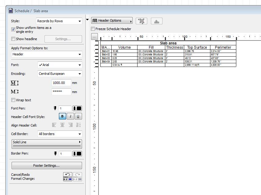

Rick Taron
Here are the settings
Windows10 ac25
Washington, usa.
Steve Jepson
It works. Probably Project Preferences. Fix units and update.
Rick Taron
You were right. I checked the preferences and my slabs were too small for the accuracy setting. So I bumped up the accruacy and added some more slabs but now I cant get a proper total.
this file was an existing 13 import so I tried a new file with the standard AC14 template.
Same thing, incorrect total Cubic feet total.

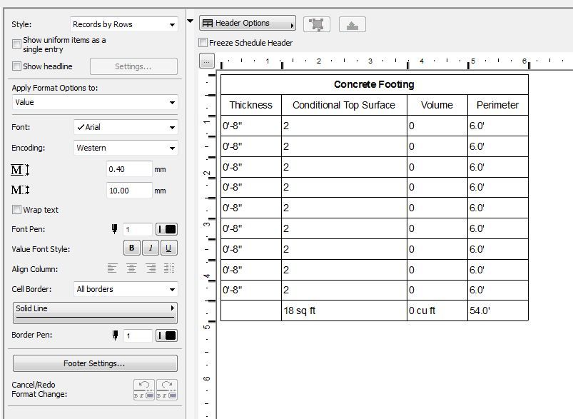

Here is the shedule from the new 14 test file.
Windows10 ac25
Washington, usa.
Steve Jepson
You may need to drag the schedule onto the Layout sheet.
From Layout, select the schedule, left click, and select update.
If that does nothing, change units and try again. Then switch back to the units you want. Schedules can be fussy.

Rick Taron
Here I switched to cubic inches.
Weird stuff.
