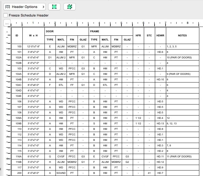

This keeps happening... open up the Layout with the Door Schedule and only the headers display. Update Drawing and only the headers display. Open Source View from Context Menu, all doors are scheduling as expected. Go back to Layout, Update Drawing, and schedule finally shows.
I've got to think this is a bug.
How it appears on the Layout...

...and the Source View:

Thanks, Katalin -- I've uploaded the movie. You can see that the schedule will only update if the View tab is open. Once the View tab is closed, and the schedule is Updated, the Drawing goes back to headers-only.

Hi All, we have observed the file of the user. The reason of this phenomenon is a Missing Renovation filter: Right click on the Schedule in the Layout view and choose "Modify Source View Settings...". Here you can see that the active renovation filter is missing, it is possible that doors are hidden in it. (see attached a screenshot about this - Set the filter to "New Construction" and the data will appear) Best,
