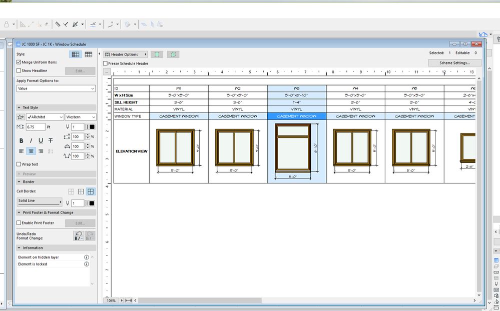

Aloha All,
I am unable to edit the schedule matrix to the proper types etc. . .
W1 eg is a Gliding window, yet it appears here as a Casement.
Other AC21 users are able to edit and change this in the screen pix shown, but i am not, right click I get 'what's this' which leads to nothing that helps
Editing in this window is ok, but,
I would prefer to know how to define this window in the window tool so it appears correctly the first time in the schedule.
many thanks
dean
1 REPLY 1
James B
The information panel (lower left) shows details of the currently selection. In this case the window (and wall it's in) is on a hidden layer and locked.
Check your layer settings to unlock the layer.
