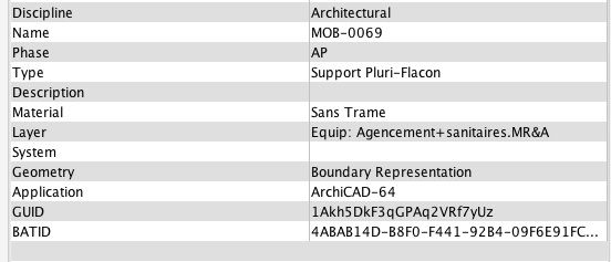

I'm checking the ifc with Solibri and realize that some of GS "internal settings" for ifc exports are not correct (ID->name is not correct, name->type neither)...
Is it possible to do something on my side to change these settings ?
Thx
Alex Moruzzi
Welll, I could answer it by myself... It is possible to overwrite the name and type at the ifcelement level...
Shouldn't GS provide a "higher linked" ifc scheme xml ?
