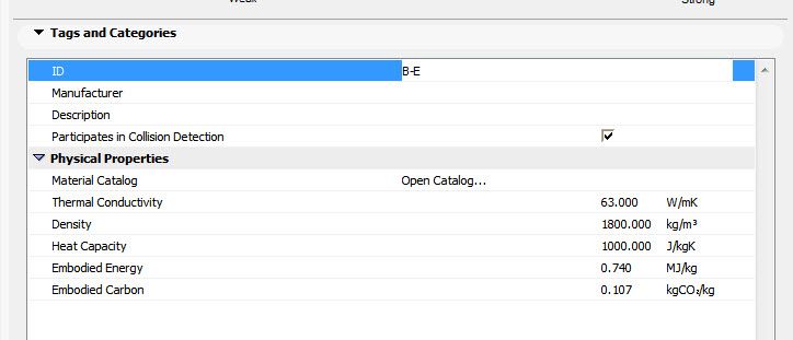

Is it possible to add fields to the current list of a building material?
We have Tags and Categories and Physical Properties
Can we add more fields?

Unfortunately no, it is not possible to add such custom fields for Building Materials.
I can give you two more fields: Structure and Appearance. Fill and Surface names can be added and edited to provide additional information to show up in schedules, etc..
