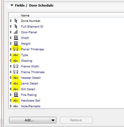

I am setting up a door schedule for our office and I'm having trouble adding the fields that I need. I am able to add "general" and "Window/Door" parameter types only. In my schedule I need to show door panel thickness, door finish, frame finish, glazing, header detail, jamb detail, etc. These are not available to me and appear to have different parameter types that I can find no way of adding, for example "text" (abc icon) for header and jamb detail call outs and "length" for door panel thickness. I've looked at using custom text fields, but I don't think that is what I need here.
The attached image shows examples of what I want to add, and is taken from the US Commercial template.
I know that I could import the schedule from the commercial template, but I'd like to know how to add the needed fields myself.

in the image you attached, next to the add tab, click the down arrow
and select add object parameters. You will have to find the window(s)
that you are using and select the parameters there.

David, thank you! It all looked like one button to me.
