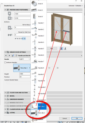

Do you not have 'Panic Bar' options for the handle types?
Is that what you are after?
Or is this yet anther difference between INT and USA libraries?
Barry
Think they are wanting a vertical full height handle.
"...bars that have the height of the door..."

I thought it might have been a typo - height/width.
But yes, if it is a vertical bar and Bidaya wants different sizes, then they will have to create a custom objects for each size.
The height position can be adjusted in the door settings, but not the length of a vertical handle.
This is what I am looking for.
