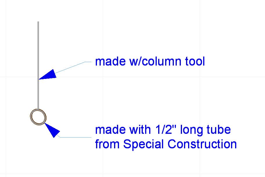

I would appreciate if anyone can point me correctly to where I can find an object to jang a pipe below the floor and/or along walls.
Let me explain:
I am using the MEP modeller for placing cold, hot and waste water pipes. I have done that, but in 3D they just "float" in mid air. I need to anchor these pipes below the slab (horizontal) or along a wall (vertical). In the real world this is achieved by a connector that is basically a long rod terminating in a ring. The ring part goes around the pipe while the long part is drilled into the slab/wall. These attachments are placed at regular intervals and anchor the pipes to the structure.
Is there such an object available for Archicad?
Many thanks.
S
3 Replies 3
Erika Epstein
There isn't one in the standard library but you could make one
- custom gdl part
-using the column tool for the vertical member and thin slice of a tube from the Special Construction section of the Archicad Library.

Thanks Erika and Aaron. I have located the object "Pipe_Support_Cyclic" in ACE library. Thiis is exactly what I needed, though it will only work for supporting horizontal pipes below slabs.
I think I will have to use Erika's suggestions for supporting vertical pipes along a wall surface.
