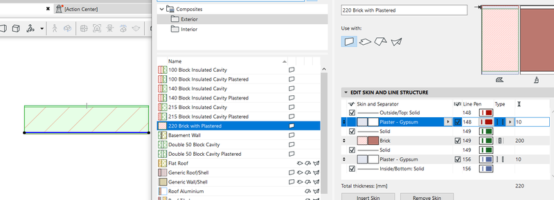

Example Brick wall with finish layer

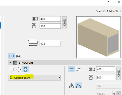

Beam with finish layer

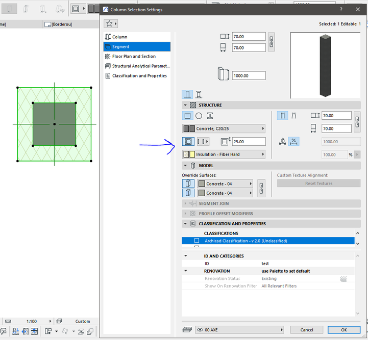

Quick example: I made a column with a veneer on top.

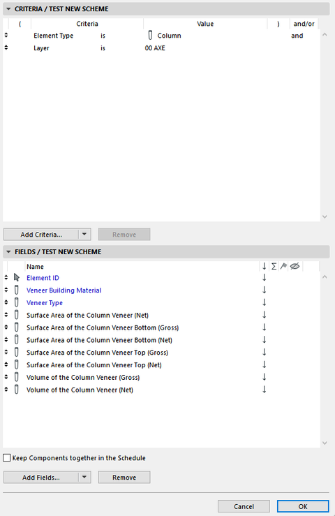

Under the components schedule, I made this schedule:
