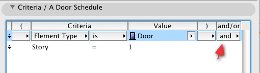

Karl Ottenstein
Moderator Emeritus
You do need to be careful and think of what 'and' and 'or' mean in a logical expression.
For example, if you want to list all doors on the 1st story, be sure to use AND to join the two criteria. (Prior to 13, AND was the only option, and so was not shown.)
If you accidentally used OR in the screenshot attached, you would get all doors, regardless of the story, as well as all other elements that are on the first story.
You know what they say about "with power comes responsibility". 🙂
Karl
AC 28 USA and earlier   •   macOS Sequoia 15.4, MacBook Pro M2 Max 12CPU/30GPU cores, 32GB

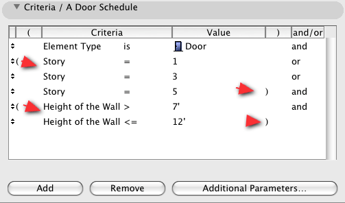

Karl Ottenstein
Moderator Emeritus
OK, a last example before I take my congested head to bed:
The attached silly example filters all doors that are on floors 1, 3 or 5 and are within walls that are between 7 and 12 feet high (but not including exactly 7').
Trying hard to come up with a back-story for why this might be a useful query...(not likely)... suppose you have a split level structure, so that stories 2 and 4 are offset from 1/3/5 and will be built and scheduled separately. And then imagine further that you have used some doors in walls shorter than 7' as cupboard doors and don't want them in your schedule. No idea why we don't want walls taller than 12'.
But you get the idea ... huge flexibility now.
As I have often written since interactive schedules were first introduced in 8: they do not have to be schedules!
Think of them as editing and auditing aids as well. Within the schedule window, you have a button that lets you select the elements in the model, and of course you can alter parameters in a schedule window. So, these can be convenient ways to navigate certain data groups in your model, as well as to edit them. The actual schedules that appear on CD's can be something else again.
