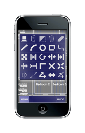

A company called Fresh Design Base have just released a pretty decent 2D CAD app on the iPhone/iTouch called SitePAD.
Its a bit tricky to get to grips with but looks promising. Theres some sort of cloud computing file transfer system to allow you to take your drawing in and out of your desktop CAD app. Looks like it has real potential for those of you who work out in the field or on 'site'. Their website has a bit more info, www.sitepad.co.uk.
Word is it will work on the iPad using screen doubling mode, but there is a native iPad version in the pipeline.
Might be the first step to mobile and touch based CAD'ing!?

It's not intended for doing your 'work' on, but those situations where simple, quick CAD drawing would be more efficient than sketching with pen and paper, then transporting that info back to the office where you have to re-draw it on your desktop. With SitePAD you can quickly and easily produce an outline plan on a device you have in your pocket. You can then send it straight back to the office where your collegues can start working on it before your even back.
It will like all iPhone apps also work on the ipad and there are plans for a native ipad version too.

Looked at Sitepad, but that interface seems to be connected through
their website at £15 a month; No thanks.
lec
There is a subscription for the drawing export. Is £15 that much though? That's £3.50 a week, which for multiple transfers on a job could easily be factored into the job costs?
There's a free trial of the service too so you can see if it works for your business first.
Fresh Design Base have said they will offer subscriptions packages to suit everyone, including students and low usage users.
There's supposed to be a payas you go option as well as a SitePAD pro that will let you import/export directly both in the pipeline.
Surely there's something there to suit?
