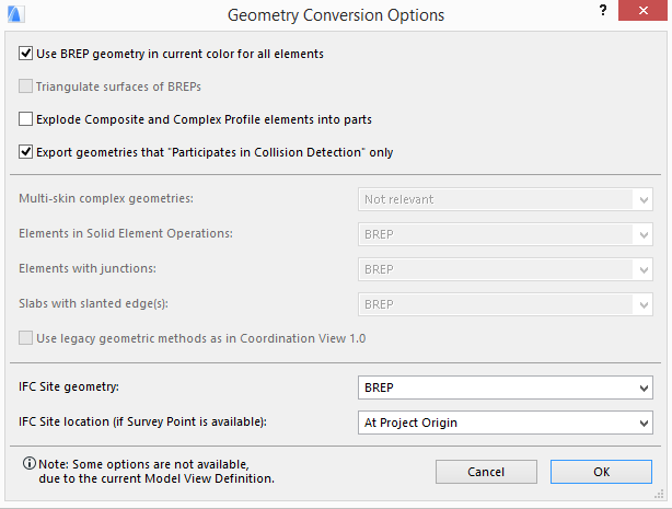

We are having an issue with few of our files where the IFC we export take very long time for Revit Users to open and the elements within it come in as 'in place elements' rather than manipulable slabs, roofs, walls, etc.
When I say long time, I mean that a 2.5Mb file takes about 15 minutes and a 25Mb file takes about 1 hour to open.
During some in-house test we noticed that the opening process slows down significantly when a window saying 'Creating Schedulable IFC Parameters' appear.

Currently we have no IFC elements in our ArchiCAD files, they have all been removed and IFC properties been deleted (As far as we can see within 'Manage IFC Properties' for the different elements), but our exports still have the same issues mentioned above.
as test, we have also opened a fresh new AC file, set the storeys and copied-pasted the main bones of the building: (walls,slabs,roofs,beams,columns) from the original file to the new. Result: same same: long time to open, elements not fully editable at the Revit end.

I have no experience with IFC exports but has it got anything to do with the Geometry Conversion Options set in the IFC translator you are using?
Thank you Barry.
We have tried with two options as per attached screenshots.
Didn't make a difference on the aspects we have issues with.
I don't seem to be able to attach 2 pictures.
I've attached the Project Geometry Settings. The General Translator is visible for everyone and has the BREP ticked off.
