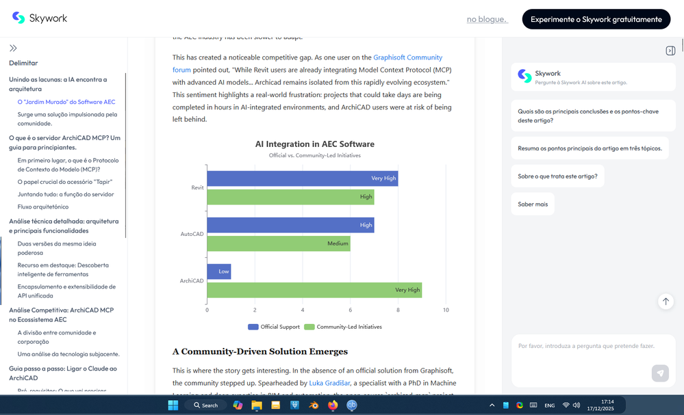

Yes, unfortunately. Maybe it's better to ask there (Blender dev). Speaking of efforts, testing the ArchiCAD-Claude, ManusAi, etc. integration, I came across an article that presented a graph showing the manufacturers' efforts in relation to the community, and curiously, regarding ArchiCAD, the community is the one that is most actively trying to expand the connection between ArchiCAD and other software. Initiatives like Tapir (JSON), Enzyme, Bimdots (USDZ,Fragments Exporter) etc.
