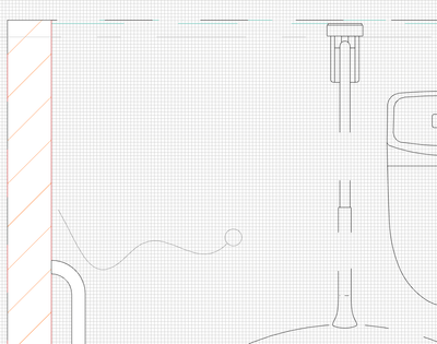

In your Grids & Backgrounds settings, you have a main grid, auxiliary grid and snap/nudge grid.
If you select an item on plan and you want to move the entire selection, you can press SHIFT+arrow to nudge it in that direction.
But that is moving the entire element, not just stretching one end of a wall.
And in my opinion, a grid snap as small as 1cm will be a real pain.
When ever you are moving and stretching something, never just use the mouse to drag by looking at the co-ordinates or tracker values.
The numbers you see will never be accurate - unless you are snapping to a grid.
Always type a number.
The values you see will always round to the nearest unit you have set your working units to.
So dragging 10cm will show 10cm even when it is really 9.7cm or 10.2cm.
Only drag and let go with the mouse if you are snapping to an existing element (node).
