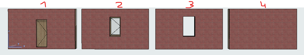

Archicad: four times the same wall, with different opening elements

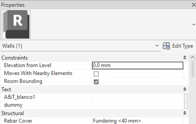

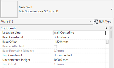

case 1-3: geometry and type of wall is correct, but element is not editable (type dropdown does nothing, properties missing)
case 4: wall is fully editable in Revit (type dropdown works, parameters are working)

Try to turn on the "export gross geometry of elements" in Geometry conversion of IFC export.
IFC element type will be IfcWallStandardCase instead of ifcWall.
