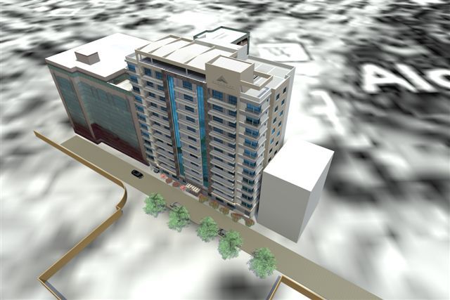

Djordje
Moderator Emeritus
If on Windows 64 bit and using ArchiCAD 15 64bit:
- install ArchiCAD 14 32 bit
- install Google Earth Connections for it (there is no AddOn for the 64bit version)
- grab the terrain
- get the context buildings from Google Warehouse (that's where they are stored)
- while there, get all the other stuff you need from Google Warehouse 😉
- save the file
- merge into your ArchiCAD 15 file
and that's it.
The 64bit ArchiCAD 15 Google Earth AddOn only imports SketchUp models, saved as SKP to your local disk/network, and does not import the terrain mesh from SKP or KMZ, AFAIK. It however enables you to work with the data placed into an ArchiCAD file as described above, that is merged into your 15 file.
Attached is an example ... not too many context buildings were available for the site, but one was enough
