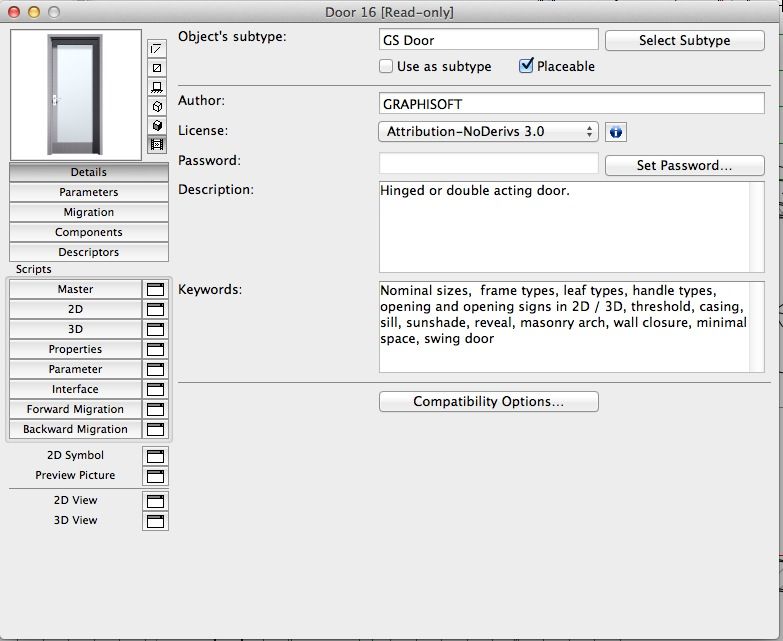

so what i did -
1) extract the Library Container File
but then i don't find the way to modify all the doors.
If i select one door > click File >Library and Objects > Open Object > then I still get the READ ONLY option, the same as before extracting the folder.
Do I have to change the folder that the object is taken from? Or what else?
Hi Lasma,
you have to:
- link to the new library folder created extracting the lcf file (if you reload libraries you will have now tons of duplicated objects);
- delete the link to the original Archicad Library and reload libraries (duplicates will go away)
If the folder of the extracted library container has the same name of the original library, when you link it, you will get a message asking if you want to substitute the libraries and step 2 is no more needed.
Bye
Got it ! Great! Thank you so much! It works!
