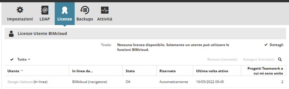

I'm an Italian high school teacher and I use Archicad whit my Design course students.
For the first time, my class is collaborating as Teamwork on a project, so we're trying to use BIMcloud as right tool to aquire this knowledge and competence.
I have a school educative license for all of my lab PC workstations and my personal teaching laptop.
Every one of my students has a personal educative licence for his laptop, obtained from Graphisoft site.
Now we're having some trouble:
- I've downloaded and installed BIMcloud as manager and server, and I want to manage the project in which my students works as professional technicians in an office
- BIMcloud says to me that i have only one licence and when i try to give licence to all user I've create, software answer I haven't enough. How could I solve this? (images 001.jpg ; 002.jpg)

1. Licensing
BIMcloud is the paid production plan of the BIMcloud family where all users must be able to reserve a so called BIMcloud User License. Same applies to BIMcloud as a Service, and the articles you pointed out are discussing options in BIMcloud as a Service. Graphisoft ID licensing is available only in this situation, on-premises BIMcloud does not have this option.
If you would like to use the basic functionality for free, you need to have BIMcloud Basic, where you don't need additional licenses, but a valid Archicad license (can be EDU license too).
