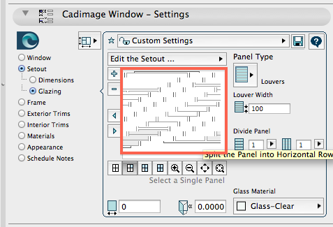

I'm trying to create a corner window using the cad image window tool. I've searched the forum and found one page that uses this mot hod, however, the version of the tool that I have seems to be different and I cannot find the option to set it to corner. (or no frame)
I've attatched a screenshot of the option I have.
Please somebody help, this is driving me crazy!

Does anybody know the specific panel that such a change would be found? I'm having a hard time getting this to work!
Thank you
Change the Detail setting (left image) to Detailed Design (you have it on Developed Design) for all options to be available, and use the "join adjacent" parameter.

This is not an answer to your corner window question, but a comment on your screen shot.
The image below "Edit the Setout..." does not appear normal (it should show the window elevation).
Is your signature correct or are you using Lion?
If so, this may help fix the image:
Mac Lion Scrollbars
Ahh yes! It works now, thank you.
I've also updated my signature - I am using Lion.
