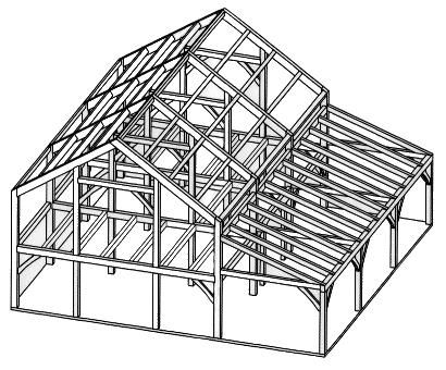

The reason why I wanted to model the studs with individual timbers ( column tool ) is so that I can show the ' skeleton' or the framing of the building ( see image )

I think you may be confusing sticks (studs etc.) and timbers. The image you show is a timber frame. Not a stud in sight, only columns, beams, purlins, etc.
Post and beam construction is fundamentally different from stick built methods. (This is true for both steel and wood framing.) Once you have a post and beam structure there is (typically*) no need for structural stud walls. Any stud framing is either partition or cladding.
As far as what to model, the general rule is to model any post and beam structure but the leave the studs implied by the modeled wall volumes (whether in structural or non-structural walls). Posts and beams have a way of significantly affecting all other aspects of the design and engineering while stick framing is specifically intended to hide inside the walls and interact only with some of the hidden pipes and wires.
