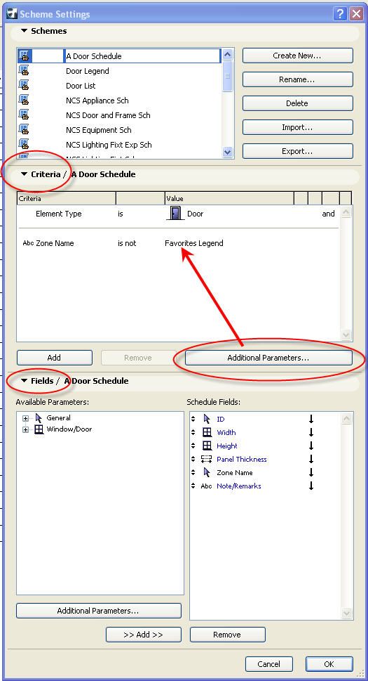

Scott Bulmer
Thanks Marc,
I see in the Criteria section of your Scheme Settings for the Door Schedule you have added the parameter 'Element ID', and that you're on a Mac. My settings on the PC are a little different, but I cannot seem to locate the Element ID parameter from the Additional Parameters Dialog Box (when selecting any door) in the Criteria section. The Element ID does show up in the lower portion of the Settings DB under General, but that is for listing only in the Fields section of the Scheme Settings. Where did you find the Element ID for Criteria and not Fields?
Thanks,
Scott

Scott Bulmer
Hey Marc,
Our Scheme Settings DB's are different. BTW, your's looks much nicer and seems to be more user friendly. Unless I'm missing something, I don't think AC10 on a PC can do what you have posted for AC9 on a Mac. I'm starting to get a little disturbed.
Thanks & let me know if I'm way off base.
Scott
