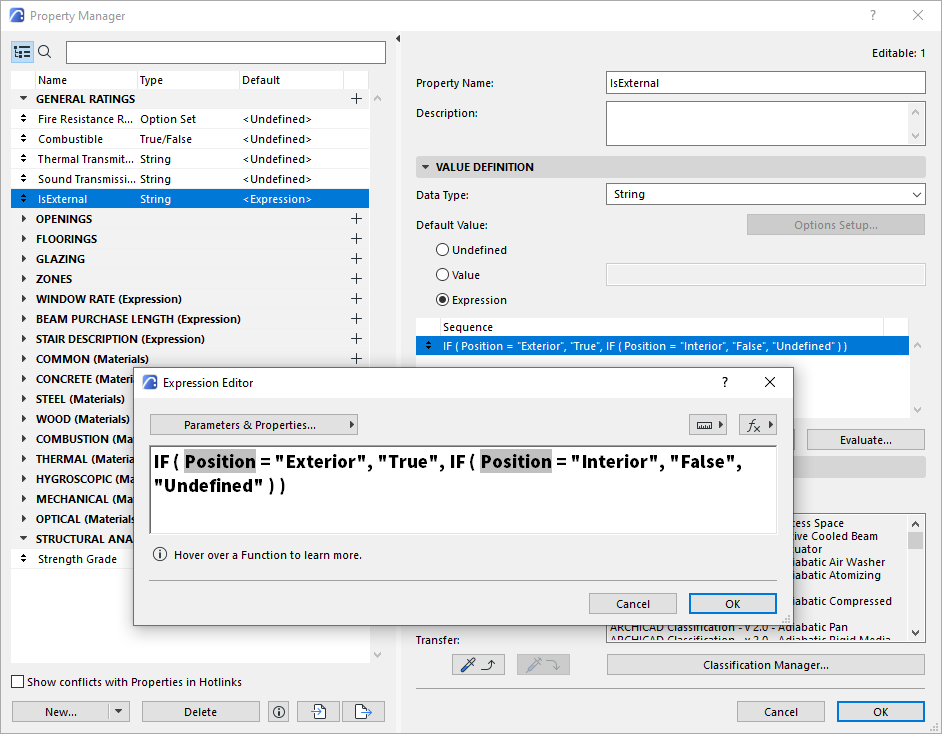

Hi!
We have a klient that wants to have a parameter in the ifc export that is called "IsExternal" and gives a response as "True" or "False" if the object has a position as "Exterior" or "Interior".
I have tried to do this, but I don't get how to do it.
Can you help me?
Kind regards,
Maria
1 ACCEPTED SOLUTION
Solution
Hi Maria,
Did you use the "Position" parameter in the "General Parameters" Group?
You can try to copy-paste the following code into your Expression Window, see if that works (triple-click to select the whole expression).
IF ( {Property:CategoryPropertyDefinitionGroup/Position} = "Exterior", "True", IF ( {Property:CategoryPropertyDefinitionGroup/Position} = "Interior", "False", "Undefined" ) )
Another thing that may cause an issue is the separator character between values in the expression.
Depending on your operating system settings, it may be a , (comma) character or it may be a ;  (semicolon) character.
If the above Expression does not work, try to write semicolon instead of commas in the Expression.
You can actually check the expressions in one of the default expression-defined Archicad Properties.
Or you can click the "Operators & Functions" button in the Expression Editor, hover your cursor over the IF function and the little Info Tag will appear that shows the expected format of the function including the separator character that needs to be used.

I think that this ifc parameter is directly exported when you assign the external/internal parameter (by default: non defined) that is accessible out of the box for each Archicad object.
If you use one of the included ifc traductor, it should be automatic.
Here is how to do it:
1. Go to the IFC Translator Dialog.
2. Click the Ellipsis button (...) to the right of the Property Mapping field.
3. Create a new Preset so you will not modify the default Presets.
4. Go to the "Map IFC Properties for Export" Dialog.
5. Select "IfcElement" on the left, and click the "New" button at the bottom. Create a custom IFC Property: set its Set Name and Name ("IsExternal"), its Type is "Single Value", its Value Type is "IfcLabel".
6. Click the "New Rule" button to create a new mapping rule.
7. Click the "Add Content" button and select the "Position" General Property (it is in the "General " group. Click OK.
8. When exporting as IFC, make sure that the IFC Translator you use is using the Property Mapping Preset that you created because this custom IFC Property and its mapping Rule exists only in that Preset.
The previous post shows how you can directly map the value of the Position parameter to a custom IFC Property.
In your case, this is not the intended result since you want the value of the "IsExternal" custom IFC Property to be "True", "False", or "Undefined", depending on the value of the "Position" Global Parameter. To do this, you can create a Property in the Property Manager with the following Expression and map that to the "IsExternal" custom IFC Property. (Make sure the Property's Data Type is "String" and it is available for all Classifications.
Please note that when you select an element and go to its Settings Dialog, you will see the Position parameter, the Property you created, and the custom IFC Property you created.
Since the Property is defined by an Expression, the custom IFC Property does not show its value. I don't know if it is because the value of the Property is not evaluated or for some other reason.
However, if you activate the IFC Project Manager Dialog you will see that the value of the custom IFC Property is evaluated and correctly displayed. (Just make sure the correct IFC Translator with the correct Property Mapping Preset is selected before entering the IFC Project Manager - remember, this custom IFC Property and its mapping exist only in that Property Mapping Preset.
And checking in Solibri shows that the custom IFC Property is correctly created and displays the correct value.
