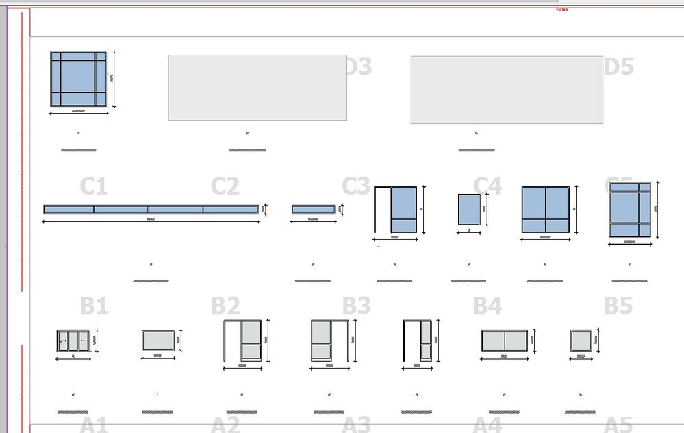

In my example I scheduled all 3D elements with IDs that begin with either D or W.
This gave the option of including the curtain wall PANELS which I had made either door or windows and given the appropriate ID.
The only problem is some parameters like Height and width for the CW must be called separately from similar ones for the doors and windows
HTH

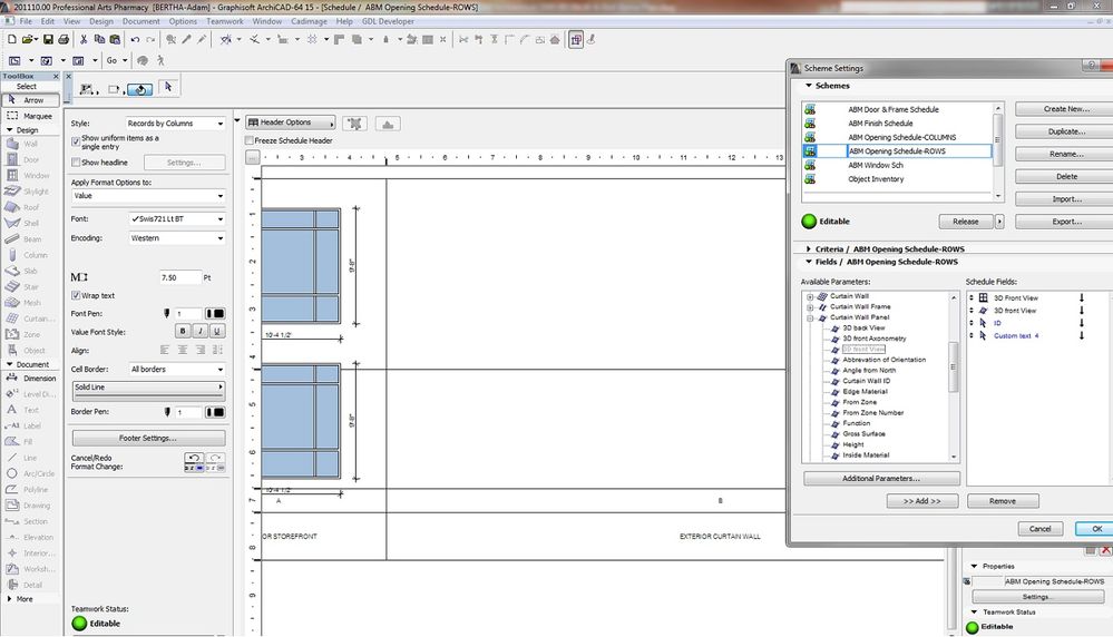

Thank you so much for that. I scheduled "All 3d elements" and filtered out the two curtain walls BY Element ID name. But unfortunately the place where the elevation is supposed to show up is blank.
Any ideas why this is happening and why the 3d elevation is not showing up?

Can you post a screenshot of your scheme settings ?

The fields are shown in the previous image and the criteria are included in this image below:

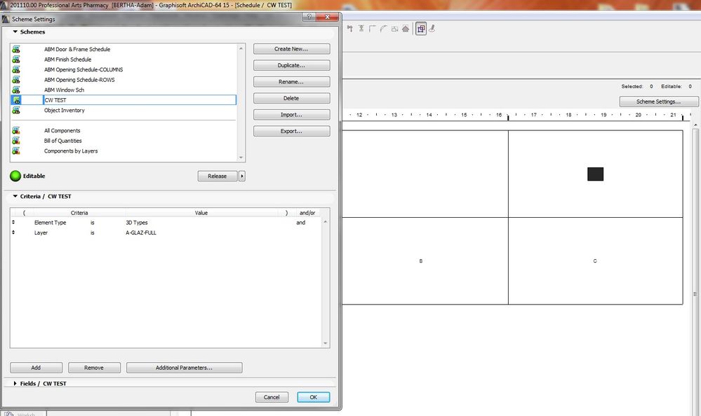

Here is a little test schedule I setup. I at least got the curtain wall names "C" to show something. its a big black square, but at least something is showing. Is that perhaps just one panel from the whole curtain wall system?

Attached is the exported openings schedule I made which you can import into your project. I included a storefront in the criteria. I find it easier to use the ID manager and give prefixes like D for doors that I want to schedule. Others prefer the opposite and scedule a type of element and then add qualifiers ruling out empty windows etc. Both work.

Erika Epstein
and here is a screen shot

Ah, so things made with the curtain wall tool will not schedule...
Unfortunately I used the CW tool and its a special n shaped window, so the storefront tool isnt going to work for me.
Is there a way I can just create an elevation of the two Curtain Walls outside of the schedule and then just place those elevations into the schedule in the blank spaces i have made for them?
