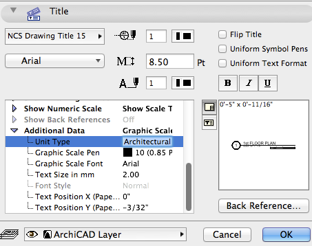

while I still have you as a captive educator, do you know if there is a way to force the graphic scale to be a different scale?
This opening schedule in the view map is 1/4" = 1' and when i bring it into the layout sheet it says that the original scale is 1' = 1' and the drawings scale is 1' = 1' (magnification 100%). So the actual windows are at the 1/4" scale, but the graphic scale beneath the schedule window is showing 1" = 1".
Any ideas as to why this is happening?
Erika Epstein
You are welcome.
Not sure which graphic scale you are using. Is it the one that is part of the drawing title: see attached photo? It looks like you are, but the drawing is the one from the schedule which is 1:1.
If it is the drawing scale library part symbol, it is reading the scale of the layout which is 1:1.
What you can do is use the title from one of the CW elevations which are separate views at 1/4" and turn off everything but the graphic scale.
You will have to put a small circle radius and line length in to not get errors, and/or use the white masking pen 91. When you place the graphic scale, if you use the small circle and line lengths (1/64") if you leave the pen black you can hide it by placing it on the line of the title.
Save it as a favorite, and then it will be available for other layouts.
HTH
