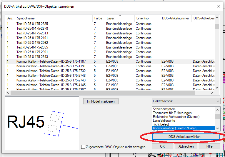

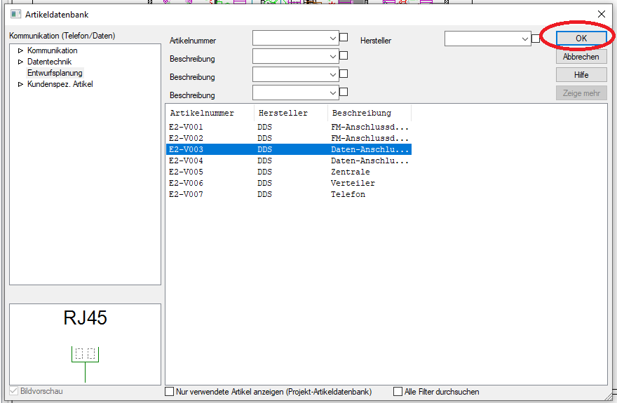

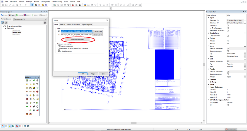

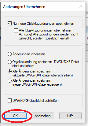

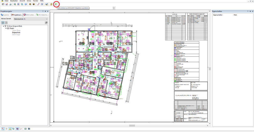

Hello,
there is this option to Map DWG/DXF object to intelligent DDS-CAD objects.
I did everything according to this The_DDS-CAD_technical_telegram_-_Issue_9.pdf
However the new objects are still not visible after "Apply changes made in
symbol mapping”
What did I do wrong?
Please help!
Thank you!
p.s. The goel is to import a DWG. what was exported from DDScad. But we cannot get the original DDScad folder, because the company refuses to give it to us. But with a DWG work is limited in DDScad.
There is this option to read the blocks of AutoCAD (what DDScad made), as DDScad objects, but still it doesn't work.
I would be satisfied with any solution what enables our partners to send us data, what we can easily use in DDScad without sending their whole Project folder.
