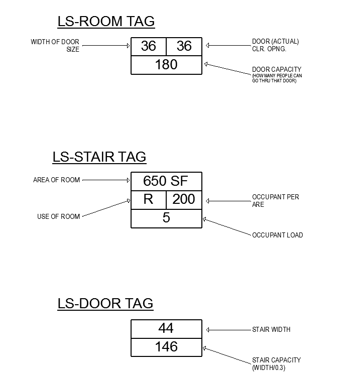

So...we have the request on how to make our LIFE SAFETY work easier.
here's what I have been tasked to do:
1. create a "ROOM TAG" as show on sketch with parameters indicated.
2. create a "DOOR TAG" as show on sketch with parameters indicated.
3. create a "STAIR TAG" as show on sketch with parameters indicated.
Now...even these were simple/ non-intelligent objects that were all three connected together....that would suffice for now. I'd input the information manually and be done with it...would be nice if they could extract information from doors/stairs etc...but that's asking too much programming so manual input would be nice...so long as these objects aren't a series of lines/texts/ rather ONE object with variable texts in them.

rob2218
the explanation sounds more complex than it is.
it's 2 or 3 customizable text boxes (text with a frame around it) which are packed together with internal variable lines of text that you can write information in them.
I tried to grab 3 texts and turned on the frame around them. located their "insertion point" and grabbed them together, then tried to do the "save selection as object" function but they lost their text variable and it AC just made ONE giant box without a parametric text inside....😞

rob2218
SORRY.....my graphics was a bit out of order...here is the correct graphic explanation of what is needed. I've added a little more verbiage to the graphics.....ignore the first graphics please.
