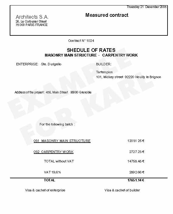

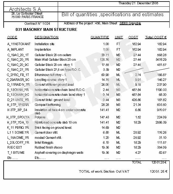

Well, we prefer a constructive attitude which criticizes, also we attach for you two very simple examples. If that can help you. We think in more than this type of document is universal, because we hate to hear that there is several "archicad" in different countries because there are various "kind" of exerting our job. All the architects in the world publish one day for their customers this kind of estimated. You understood that we would like to be able to do that with a minimum of °click°, unfortunately we remake almost all on Excel. If one day a book is published on the subject it will be quite useful, but handling will be they simpler? we are not sour ! We wish you a happy new years
second example
