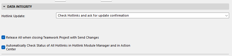

For example, I like the fact that you can ensure that project elements have been released on teamwork projects by toggling an option in the data integrity settings in work environments.

And just a little heads up, the "release all" option does not really do what it says. See here: https://community.graphisoft.com/t5/Teamwork-BIMcloud/Release-all-when-closing-Teamwork-File/td-p/60...
There is also a problem with reserved Elements that are not granted before one user leaves. Say that the first user sends a request. He didn't get it granted, but needs to go home for the day. He sends his changes, releases all and closes everyting. Then, a second user finally sees the request from the first user, grants it without thinking and now the first user who is already offline has a bunch of stuff reserved and no one can use it until they kick the first user from the project or until he goes back online...
