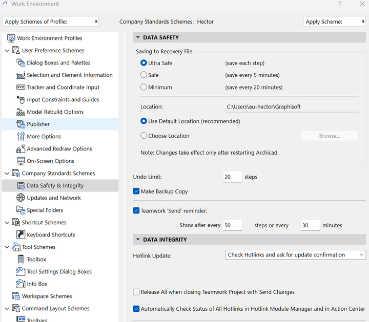

Am I completely missing something, or is this a big nothing setting in the work environment? I have it checked, everyone I know has it checked. Everyone still deals with latent users (not in the file, but with inactive connections) retaining reservations after they have closed.
Is this a feature that only works for full BIMcloud, not BIMcloud basic? Or is it just a dummy box that was never fully developed?

We experience the same thing. We have that setting on all our workspaces but someone people every so often manage to close without releasing all

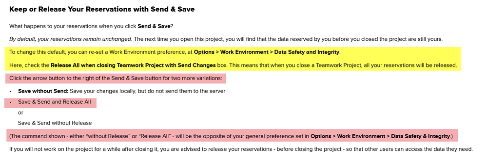

I’ve worked out if you hit Ctrl+S and then close Archicad it does not give you the ‘do you want to Send/receive and Release All’ dialogue and Archicad just closes cause it thinks there are no unsaved changes.
That setting only changes the default option to Send/Receive and Release All dialouge, not actually automatically do the release all, so the user still has the option to just S/R and not release all.
My wish is: with that setting on, always make the Release All dialogue come up.
We make a big deal in our office about people remembering not to forget to Release All and the impact it has on everyone else to they do forget.

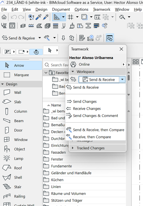

If the Work Environment is set to 'Release all' and it is not working, there seems to be another way of doing it.
Don't set the Work Environment to 'release all'.
Then next to the 'send & save' button will be a small arrow that will give you the option to 'send & save and release all'.
Then I assume you would have to close the file close.
Of course the 'release all when closing teamwork with send changes' should do as it says.
But it seems to me there should then be a command to 'send changes and close', which there doesn't seem to be?

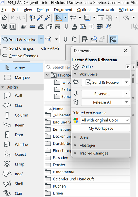

Hi @Barry Kelly ,
I have set the Work Environment to NOT 'release all'.
but it does not appear the next to the 'send & save' the option to 'send & save and release all'
I´m missing something or doing something wrong?
Thanks in advance
Hector

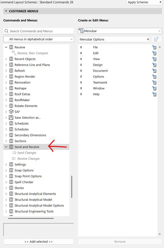

I looks like you are using a custom Work Environment.
You will need to switch to a default Archicad Work Environment or you will need to add those commands to that menu so they appear in the toolbar pop-out menu.
But having said that, I just looked in the Work Environment and could not see these commands at all.

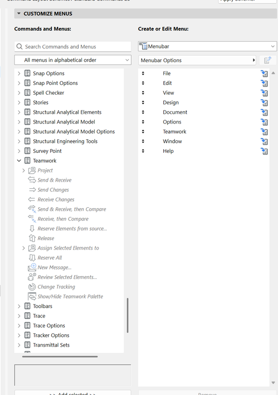

Hi Barry,
You mean here?
But does it appear in the default Archicad Work Environment?
