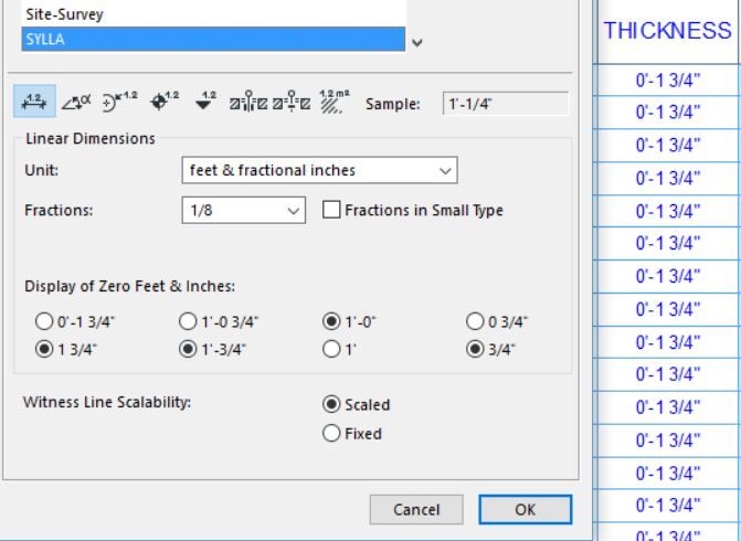

Dimension Format in Schedule
What setting can I use to do away with the 0 in front of 1 3/4". The dimension scheme I am using should do that but it does not. Thanks.

After playing around with this, I believe it is a bug. And it was the same in AC20.

There are several problems displaying units of measure in Schedules that never seem to get fixed. Make a Door into a Cased Opening by selecting the Empty Door Leaf and see how the dimension of the leaf is scheduled - and there is no leaf ! The display of leaf thickness in that case is controlled by Calculation Unit Rules.

Hello Cheikh T Sylla,
You are not doing anything wrong, this is a bug, we are working on fixing it. It does not look nice, but luckily the value is correct, so until the fix this shouldn't cause imprecision issues.
Also, the problem Steve mentioned is a library issue that seems to be specific to the doors in the US Library. I have tried with INT doors as well, and it worked fine. I have let the developers know about this issue, hopefully it will be fixed.

To the person I am selling the Plans to, the defects in the program make me look like I don't know how to use the program properly.
