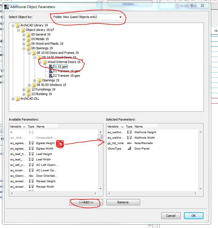

Ok, So at the begining I was having the same problem of the decimal inches. The way I solve this was the next: (I hope it works with beams too)
In the dialog box of scheme setting of the shedule, instead of adding the fields from the add button, you press on the down arrow next to it and choose add object parameter from the drop down list. (Screenshot 1)
Then you browse for your object type and choose and add the parameters you want to show in the schedule. EYE with this, in order to make the browsing easier on top there is a Select Object by option, there you can filter what the list is going to show you.
And, this is it. Your numbers should be in fractional feet and inches.

Steve Jepson
Yes. I can do that for beam height and beam width, but not for beam length which is only displayed in decimal feet.
