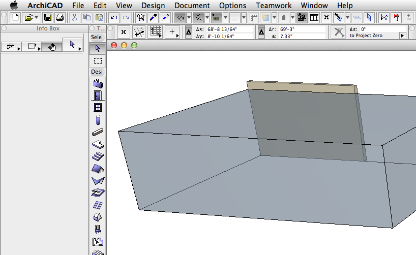

No problem exporting the 3D zone here ... it might be a Revit issue, as the (free) Solibri viewer shows the zone just fine.
Attached is a simple zone and one wall as seen in the AC 16 3D window...

...and here it is in the Solibri viewer.
The zone is exported as an IFC Space. When I first opened the ifc file in Solibri Viewer, I did not see the zone. I clicked on the Space item in the tree and it appeared (highlighted in green), then clicked away, and it remained visible, translucent as in AC.
Alternatively, there is a Show/Hide Space button in the toolbar that shows/hides the IFC Spaces (i.e., AC zones).

This is great news thank you Karl for your time and valuable feedback.
I must get myself a copy of Solibri, that's clear.
