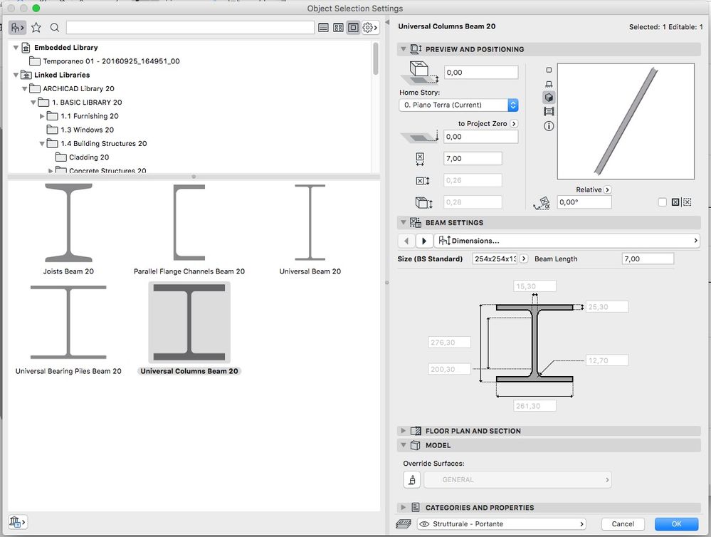

I trying to export the beams of the Archicad Library in IFC.
When I import again that in Archicad and suppose in Tekla, it does not recognize them as normal beam native archicad component: extrusion of a profile along a vector.
Did someone found a IFC setting to export Beam object as real beam?

I checked this and I think this is a limitation.
It is exported as IfcBeam, but it is exported as A BREP, not as an Extrusion, that is the limitation.
When a Beam element classified as Beam is exported to IFC, it is exported as an Extrusion. This is normal since in ARCHICAD it always exists as a Profile extruded along a path.
However, when an Object element classified as a Beam is exported to IFC, it is always exported as a BREP (boundary representation). This is because a GDL Object can have any geometry and only the BREP geometry method is guaranteed to produce the exact same geometry in the IFC file. So an GDL Object is always exported as BREP.
If you go to the Conversion Options Dialog in the IFC Translation Setup Dialog's Export Options panel, you will notice that there is no checkbox for the conversion of GDL Objects. This is because they are always exported as BREP due to the above.
And since the IFC contains a BREP geometry, which can be any kind of geometry (even though it is a simple Beam shape), it cannot be converted back into an extruded geometry in ARCHICAD. So it cannot be imported into a Beam, only into either an Object or a Morph, both of which can reproduce the exact BREP geometry in ARCHICAD. I suppose this works the same way in Tekla as well.

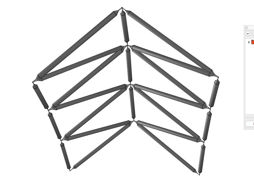

My aim is manage complex structure in Archicad then export them in tekla, such us the image attached.
