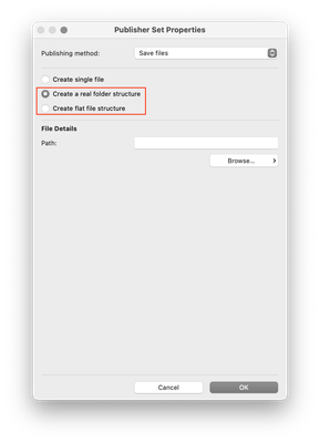

I want to export my Layout to dwg file but there is only the pdf format option. Could you please help me solve this issue?

krab-El:
Select the Publisher Set (up one level), then click the Publishing Properties... button and select either Create a real folder structure or Create flat file structure, not Create a single file.

krab-El:

Great. Thx
