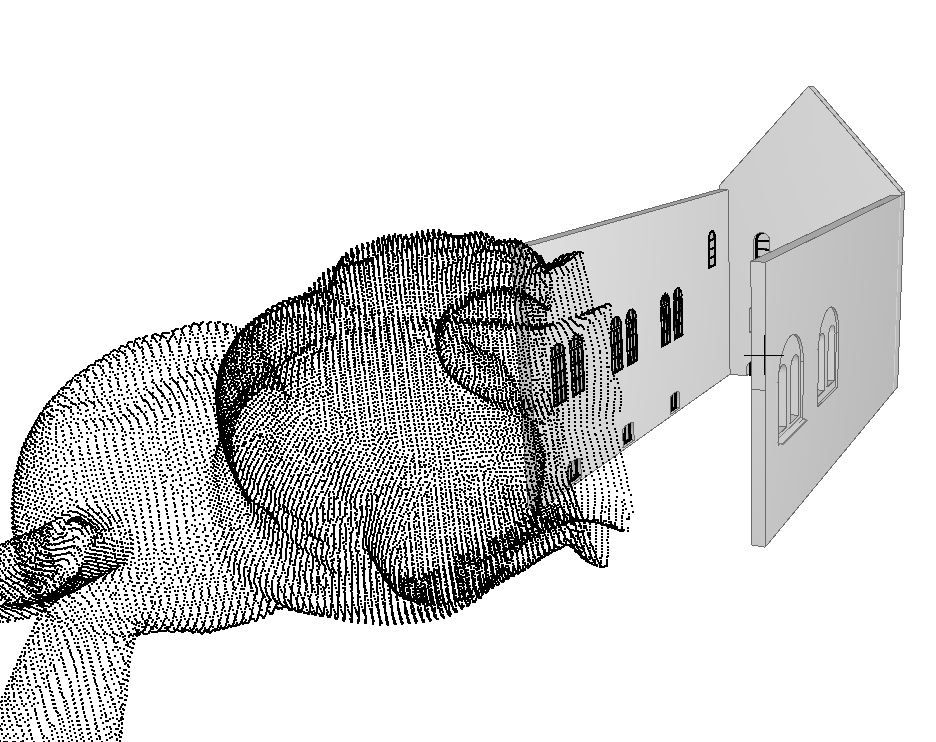

I am trying to import a point cloud (E57) in a simple model, but Archicad fails and throws an error that I will try to translate to English:
"Failed inserting object of point cloud KRYSIEWICZA... Press NEXT to continue or Quit to abort."
The model was built in AC 25 POL version.
In most models my clouds get imported properly, but randomly a couple of models end up with this error.
The problem is clearly not about the point cloud file, because it gets improted properly to other Archicad models.
The issue is with this particular Archicad model (attached PLN). It cannot even import a small sample E57 file.

You don't need import geometries to a new, fresh Archicad model or import point clouds there. You had selected the MISSING layer for the Object Tool before inserting !!! You just need to select the appropriate layer before inserting Point Cloud.Przechwytywanie2.JPGPrzechwytywanie3.JPG

Fixing the file did not work, but choosing a layer for object tool DID 🙂
