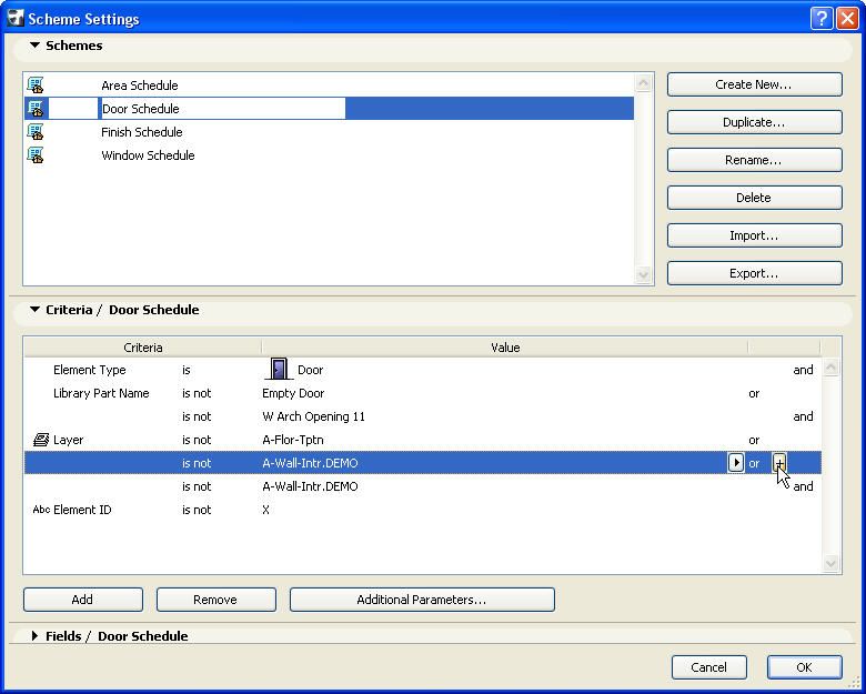

Link wrote:We use an 'X'.
Try assigning all unwanted doors an ID of say 'void', then exclude that from your schedule.

Herzog, wrote:Why don't you just give all of these doors an ID of 'X'? or follow my example and exclude doors by library part name (Empty Doors), items on your Demo Layer, and give all other doors an ID of 'X'?
SO I ASSIGN ALL EMPTY DOORS "X" AND FILTER THAT BY ID, THEN I FILTER THE ARCHED OPENINGS BY LIBRARY PART NAME, AND I FILTER OUT THE DEMO LAYER BY LAYER NAME, WHAT AM I GOING TO USE TO FILTER OUT MY EXISTING DOORS?

Herzog, wrote:In response to this question: you can. There's a button to add conditions, but it's hidden unless you highlight the criteria (see attached image).
OK, THAT WORKS, BUT WHY IS IT YOU CAN ONLY FILTER ONE ELEMENT TYPE OR NAME PER PERIMETER?

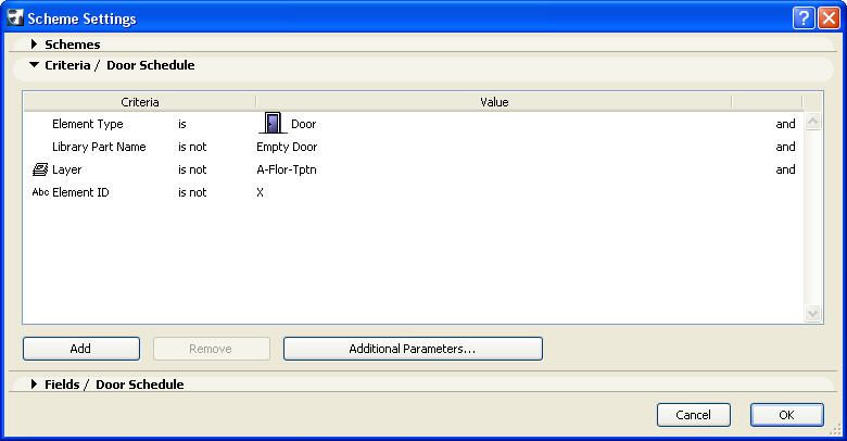

Herzog, wrote:I have done that with hitting the plus sign to add an "or" field such as a library part name, but as I stated before, if I put in a Library part name add another with the "or" neither is eliminated, they both remain in the list.
am experiencing the problem that if I put in more than one eliminator criteria if I use only one name, it won't show up but the other will, and if I use both names neither is eliminated.

Herzog, wrote:I don't which which version of AC you are using, or your system specs, but it works correctly for me in AC11 (both Empty Doors and Arched Openings are omitted from the schedule).
