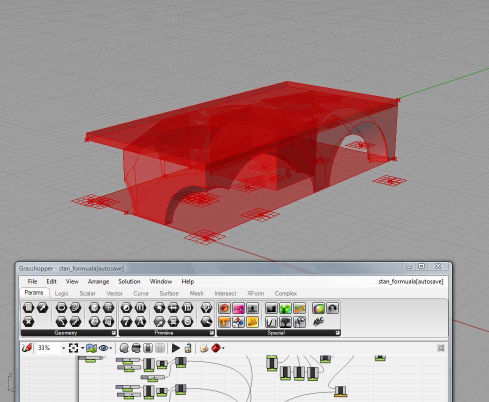

Hello Jon,
thank you for your replay. Let me clear my question. I have form created in a grasshopper (see the picture), it is a cube and spheres intersecting each others. I would like that shape in ArchiCAD, defining it like a wall if possible. And I need that as soon as possible. Is that what your plugin does? If I can do that, than it's a great tool, and a life saver for me. I can send you grasshopper file if needed.
Regards,
Pejic Petar
Hi Pejic,
Yes, you can certainly get the shape into Archicad, but it might be a simplified "meshed" version. IFC actually can convey boolean operations and my grasshopper plugin can export it in this format, but it seems archicad does not recognize this aspect of IFC (There's a another thread on this in http://archicad-talk.graphisoft.com/viewtopic.php?t=34325)

and the picture
undefined
Great, very nice, yes this shape can be exported quickly and easily.
If you can email me the grasshopper definition, I'm happy to help set it up for you. This blog post might be of interest, http://geometrygym.blogspot.com/2010/11/grasshopper-generating-ifc-update.html
