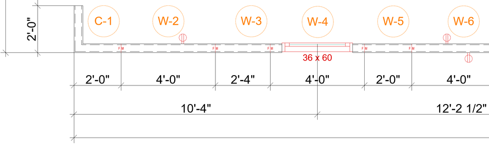

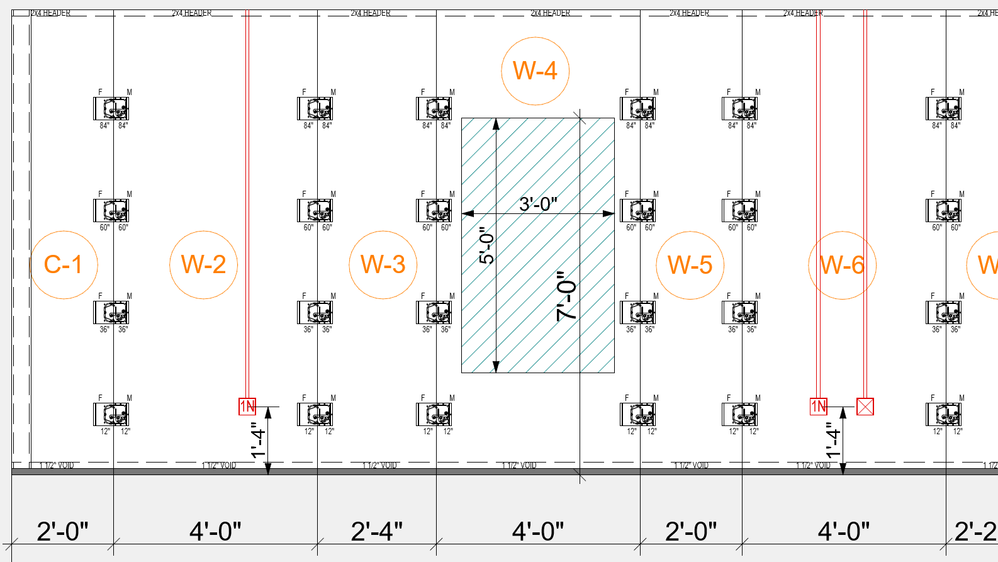

chronofreak
@mthd Sure, take a look below.

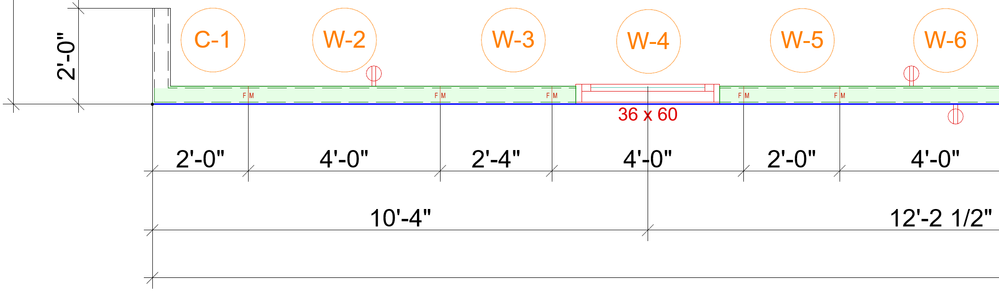

The first image is of a section of wall as seen from above. You can see where we have used notes to mark the locations of each panel--W for straight wall pieces, C for corner pieces--and the dimensions show the lengths of the panels. However, as I mentioned in my initial post, this currently all done with documentation tools; the entire wall in Archicad is modeled as a single wall and not actually built up from these panels. I have selected the long wall in the second image to show this.

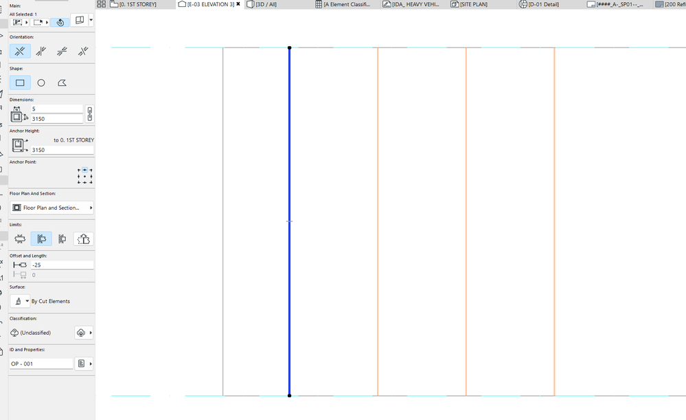

In addition to marking up the plan with the top-down perspective, we also manually mark up the plan from side views as well. See the third image of the same section of wall. Again, these are all purely cosmetic markings and notes. I feel like if the individual panels were modeled, we would be able to streamline the dimensioning process and make future adjustments more easily.
And lastly, I've included in the fourth image an example of a 2D blueprint of an individual panel, this one specifically being the corner panel C-1. Once we outline where each of the panels are in the wall in the top and side views, we use those dimensions to create these 2D blueprints for manufacturing.
There must be an easier way than doing everything manually!

You could use separate walls.
The trick is to place them in a layer that has an intersection group number of 0 (zero).
That means they will not trim to each other, but they also won't trim to other elements either.
This will be a problem for your corners, as they will also no longer trim to each other.
So for the corners you will need a separate layer with its own intersection group number that is not zero.
Or you could maybe use complex profile columns.
The thing is, you can't easily add a hole to a column for the openings.
Either of these, the same surface if co-planer in elevation will merge without a seam.
So you will need to use alternating surface materials (can be exactly the same material, just with a different name) so they do not merge.
Another option would be to use GDL objects, but you would have to get them scripted so you can easily manipulate the openings and possible size differences.
There should be no problems in plan or elevation - you should automatically see the joins.

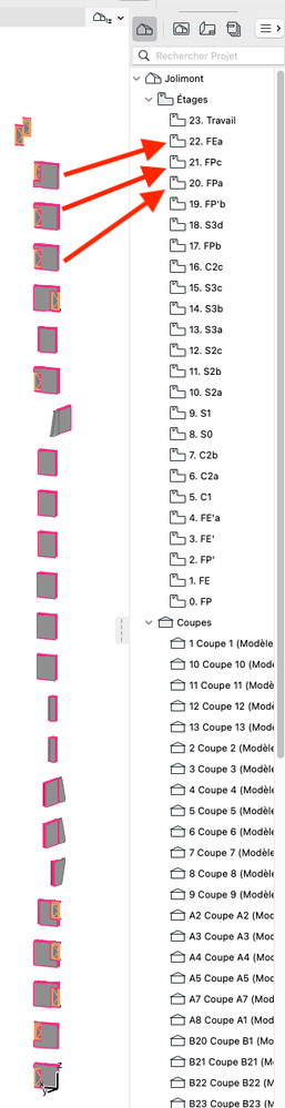

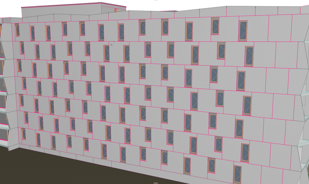

BrunoH
Hi chronofreak,
If your panels are used several times in your project or are a prefabricated construction system for several project, I would consider hotlink modules.
Create one file with your panels one panel type in each story, the design options let you create the variants of each type.
 In this file you can easily create all the construction documentation for the panels.
 Then you can place any instance of the panels in the project file as a module.
There you can create the documentation for the project.
 The use of modules allow you to create and document each panel once, and when modifying a panel in the module file all placed one will be updated.
