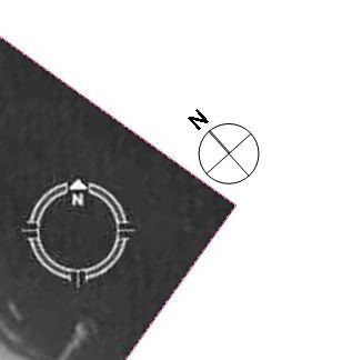

I have imported the kmz file with the origin of the project, and when i try to import a snapshot of google earth it is positioned on the right origin and the north rotated upside. I would like to have the north rotaded like the north that i set in the 3d window for the sunlight evalution, and for an easier way to draw. I've rotaded the bitmap and the terrain to the true angle and it's all in archicad 11 but when i try to export the 3d into google earth it is wrong rotaded, like if it isnt able to know that the terrain, the object (origin imported from GE), and the bitmap was rotated.
Anyone know how to rotate the origin of the GE object or what is wrong in my proceeding?

Are you sure that your project north is the actual geographical north?

Yes I'm pretty sure. How you can see in the attached picture the object "North" in the top-right is setted up with "follow the project North", but the GE positioned with "Position Google Earth picture" keep to point upside...
I've try to rotate also the project origin, or the object "GEPlacemark" but it's continue to point upside everytime

Djordje,
I hope you are right in what you say about the self alignment of the GE screen shot and the AC site plan.
However, this doesn't seem to be the case. See screen dump.
Small development, set up in AC orthogonal to my Client's building.
This puts North at 34.13 degrees anti-clock above horizontal. (North Point is just visible below the horizontal road in the terrain model)
I have used Camera/Set City/Set North to locate the site and set the orientation.
On GE I have located the site, with it's North Point still set vertically - also in picture.
When the Snapshot is placed, it is imported as a horizontal rectangle matching the screen view. This leaves it's North at 90 degrees to horizontal.
There is no APPARENT self-correction or alignment mechanism.
(I have just dumped the picture roughly, no attempt at alignment)
Now... I COULD twist the GE Snapshot approx 56 degrees clockwise to get the two to align.
OR, I could twist the AC model 56 degrees anti-clock to same effect.
With the second option, the resulting 3D AC model and terrain would align with Google Earth but would be virtually unworkable in CAD.
BUT, with the first choice, although it would look good in AC and be workable, as the construction data is still orthogonal, the model would appear in GE twisted 56 degrees out of true.
In other words, the download does not infer the relationship of the two north points. (Which is what we are requesting)
NOW... this is where you say "but you should have set X to Y and it all clicks together!" Be good if you could.

I've found two easy way to turn around the problem:
1- I've made another project, where I've positioned GE terrain and then, I've linked this project to the original project as a linked module rotated.
2- I've made another project, where I've positioned the original project as a linked module rotated (with the true north upside) and then I've positioned the GE terrain
The 1st is easier for me, but the second works when you export the model to GE

Yeah, making a second version, whether by hotlink or as a cut down stand-alone shell appears to be the current best bet.
Still hoping that there is an inbuilt system in there some where!
